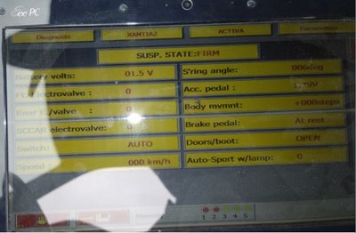

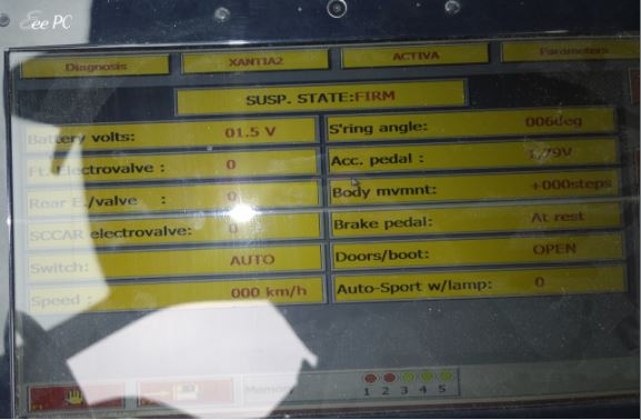

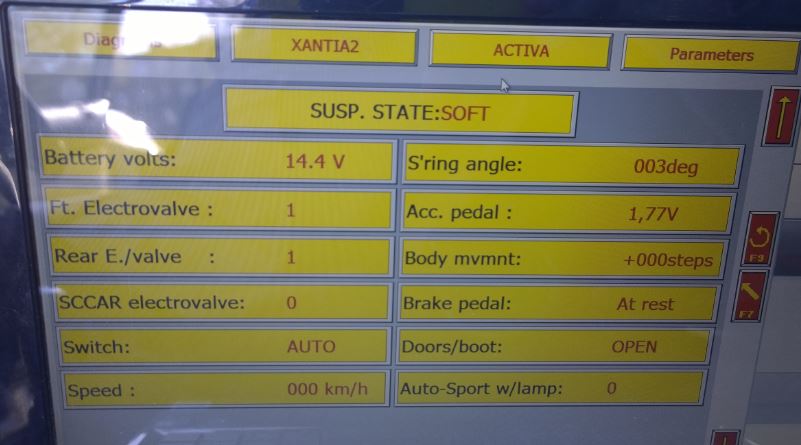

First I started to dig into the most annoying issue, the Activa (and Hydractive II) systems complete failure to work. Only basic hydraulics work on this car, Hydractive is FIRM all the time and Activa is soft (SCCAR ball in use, elecronic valve open all the time).
First study with Lexia revealed the horrible truth: Activa ECU Permanent failure code. Activa ECU also contains all functions of Hydractive II, so there is no separate box for HA. Meaning, no electrovalves at all are in use. The ECU still communicates, but diagnostics show unusual data:
Activa_lexia_1.JPG [ 40.38 KiB | Katsottu 40561 kertaa ]
The measured operating voltage is only 1.5 Volts! How can the ECU communicate then? Well, Activa ECU has two circuits with separate feeds, digital circuit that gets its power through fuse 3 in passanger compartment (via ign.key), and electrovalve power circuit that gets it feed via fuse 8 in engine compartment.

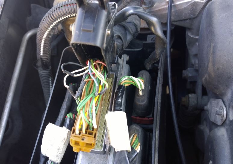

In this year model, 2000 V6 Activa, the Suspension ECU is located right on side with Motronic engine ecu, in front right engine compartment where that large plastic box is.
All connections looked like brand no = bad news, probably not connector corrosion etc. The wiring loom provides right voltages to Green pins 1,2 and 5, and ground comes through fine via white pin 8, measured from connectors.

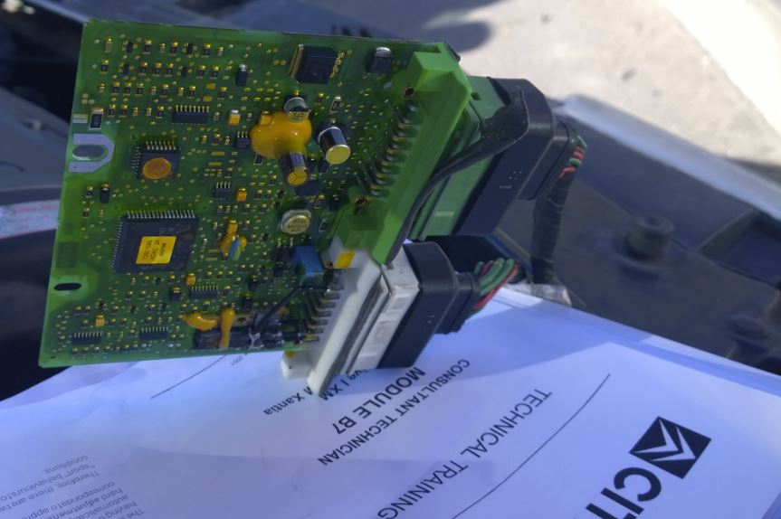

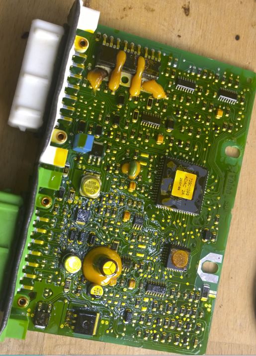

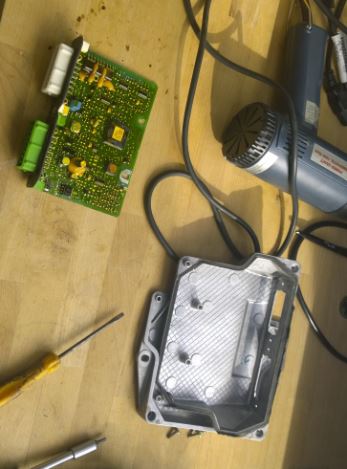

I removed the Activa Suspension ECU and took it to bench. It is naturally sealed with silicon glue, so opening required cutting the glue where possible, heating the seal gently with heat blower, and then prying open the ECU. This is what is looks like opened and dismantled:
Activa_ECU_2.JPG [ 36.26 KiB | Katsottu 40549 kertaa ]

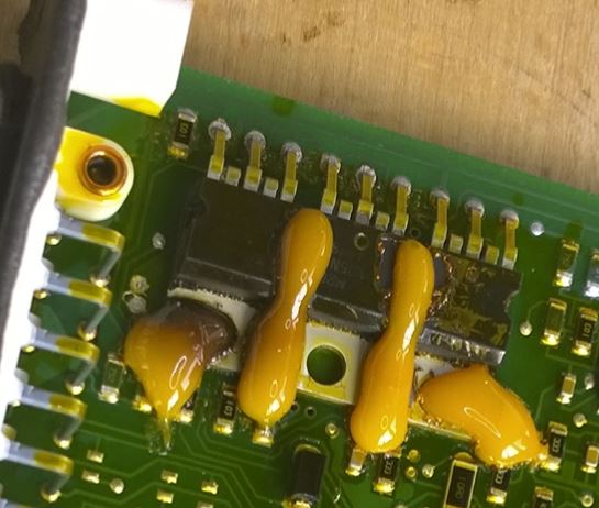

It does not look clearly broke, there is some heat signatures visible near transistor block (one unit for all 3 electrovalve transistors in this unit!), but no failed solderings or severe heat signs:
Activa_ECU_3.JPG [ 100.37 KiB | Katsottu 40549 kertaa ]
So no clear failure points, unfortunately. Murphy...
And then back to the car! I connected the ECU without casing (naturally isolated carefully by placing it on newspaper near the wiring loom, so no short circuits...) and turned ignition on.
Again, Lexia communicates with ECU but still shows only 1.6 Volts of operating voltage.
Measurement from (now visible) connector pins revealed, that pins have correct ground and correct positive 11.8-11.9 volts on every pin where it should be.
So it is not a wiring loom problem... Bollocks! This means back to the bench with ECU. Now I will try to study where the ECu measures its own internal voltage, and why that measurement only shows 1.6 volts.

Now, under suspicion are the several transistors and condensators on board. Measuring continues...

After measurements it is clear that one VN05N Driver has failed, that one that shows heat signature:

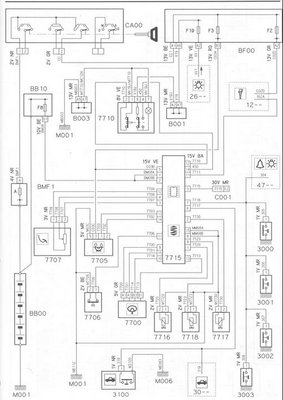

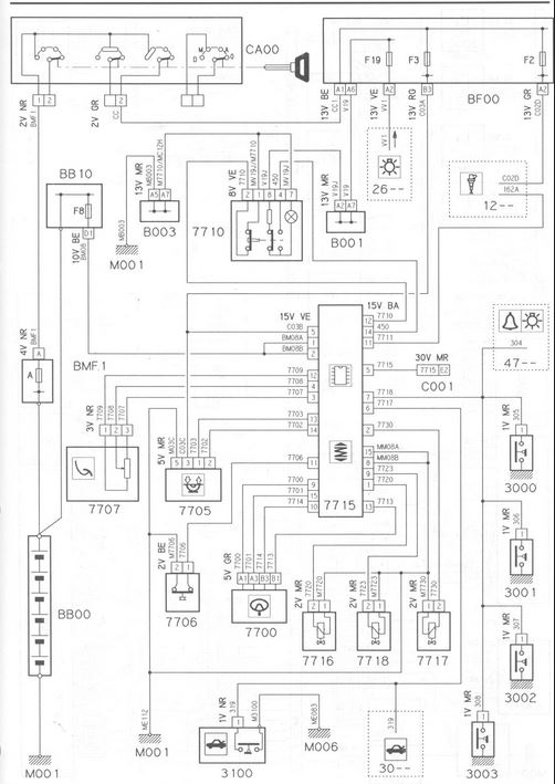

On a side note. After looking into the wiring:
Activa_ecu_pinout.JPG [ 69.79 KiB | Katsottu 40298 kertaa ]
..and description of the Hydractive 2 Ecu functions at
http://buukne.dyndns.org/Hydractive.Cit ... Manual.pdf
I could build a new version of Activa ECU myself, using modern components instead of 25 years old tech found in that original box.

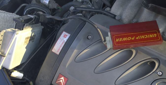

Engine runs really rough, spits and sputters on coolant temperature range 20-85. Only when 90 deg celsius is reached it will settle to "normal" idle. Now knowing this power unit and having had many cars with this (and newer ES9J4S) engine, I know this rough idling is not normal at any temperature. Something is wrong. I assume it does not run on all 6 cylinders on idle. Badly leaking exhaust makes it harder to analyze the noise, however.
Lexia does not show much. Couple of anomalities, ignition timing jumps around at idle as much as 15 degrees (strange!) and lambda sensor gives pretty static voltage on idle even after minutes of idling (it should saw between 0.2-0.8 volts all the time, now it does not).
Well, I had info that the engine had been "tuned" by the swedes ten years ago. How? It seems to be classic Unichip piggybag "tune", basically fooling Engine ECU (Motronic 7) with falsifying sensor data. This engine is pretty well optimized by PSA (to run on 98 octane actually), so I cannot believe that piggybag makes much positive difference. However, it can surely cause the ignition problems and maybe also other probs on this engine.
And naturelly it is welded directly into the wiring loom. Those swedes...
Activa_unichip_shit.JPG [ 43.07 KiB | Katsottu 40222 kertaa ]
So it is a project in itself to remove that shitbox and repair the wiring loom. Not a nice project at that.

OK, so let's bypass that shitbox (UniChip piggybag ecu) first and see what that does to bad running.

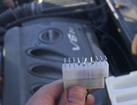

Rather than starting to cut the extra wires out and soldering originals back together at this motronic connector (see quite good swedish solderings in there),

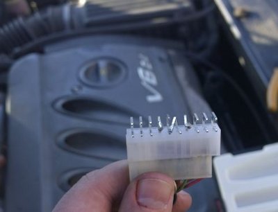

activa_motronic_connector.JPG [ 68.93 KiB | Katsottu 40106 kertaa ]
, I decided to make a bridge to the Unichip connector. Bridge will restore the original functions of the Motronic ecu, bypassing totally the Unichip which can be removed then.
As we are in Estonia, it was not hard to find electronics component shop open at 8PM easter saturday. So I went ahead and bought suitable connector (standard PC power block connector) and made prototype of bridge:
Activa_bridge.JPG [ 23.88 KiB | Katsottu 40106 kertaa ]
Only three connections (6 pins, 2+2+2) needed to be soldered together. Which ones? That was obvious after looking at the new connections and cut wires at motronic connector end.
Plug in and... start...
SUCCESS!
Engine purs smoothly like a cat, cold and warm:
http://youtu.be/LyDIOx4jd04
So it was that Unichip box that was hindering the engine. Now I just cut the extra pins out from bridge connector, and the job is done (after isolating and protecting the bridge from moisture of course).

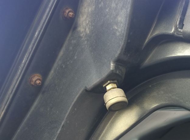

Now when engine ecu is repaired, and Activa ecu waits for part, I decided to dig into one other annoying problem of the car: deep "thumping" bass noise when driving even on very low speed.
FFT (frequency analysis of this noise) showed that frequency of bass noise was around 20-50 hz and did not change according to vehicle speed, so it was clear it is not from wheels (which was my first guess because modern tyres "square out" when car stands for long time).
After some study and speculation, I found the probable cause. Trunk door feeled little bit loose when it was closed. And behold, there are adjustable rubber studs in the trunk door:
Activa_rubber_studs.JPG [ 37.47 KiB | Katsottu 39758 kertaa ]
Maybe over time these are compressed, and trunk door can move more than it should, creating this thumping sound?
After adjusting these rubbers tighter and tightening the lock screws to 6 Nm,
SUCCESS!
Bass noise is gone. One point to cross out!

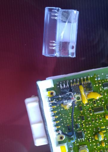

Well, the transistor is now soldered to Activa ECU. Old one was shorted. While at it, I decided to do diode mod also. See those 3 diodes (1 for each transistor) on top of new transistor:
Activa_ECUrepaired.JPG [ 39.42 KiB | Katsottu 39528 kertaa ]
These diodes are common fix, external box doing the same thing is even sold on ebay for 50 euros (the diodes cost less than 1 euro together...):
http://www.ebay.co.uk/itm/XANTIA-ACTIVA ... 2ea5803e7f
There are originally diodes to do this "pull off bounce reduction" inside electrovalves, but they commonly fail. Causing ECU transistors to overheat because they have to take that negative spark every time. New diodes do it now, so transistors should last longer from here on.

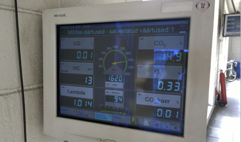

Project continues.
On the first yearly inspection (regulation in Estonia), there was - well - some surprises.
First the good news: Engine, after I removed that Unichip shitbox, is now running well and passes emissions test with flying colors and good numbers:
Activa_ulevaatus.JPG [ 51.28 KiB | Katsottu 39290 kertaa ]
Then to the bad news...
Basically the complete suspension system is worn out. Inspectioner found that front axle lower bushes and balljoints are worn out. Also sway bar center supports are worn out. Rear rubber mountings are cracked and worn badly. 3 suspension cylinders "sweat", one has serious leak. Both Activa cylinders sweat.
And fronts brakes are funtioning badly, strangely only exhibited in the slow rolling test. But hydraulic Citroens can do just that when there is small bubble of air in the braking system. So need to air that too, which is actually quite a project with this model, if one wants complete air-free brakes.
Regarding rust spots, it passes inspection still, but next year probably not. So need to weld new side boxes (outer and inner) to place, which is a major project.
Outside inspection, driving home, I noticed that air condition is not working at all. First warm day that I tried to use it, so this is why I did not notice it before. Lexia does not want to connect to Air condition ECU, so need to traditionally start to measure pressures and so on. Or it can be the common fault, engine middle speed fan function not working -> engine ECU not giving clearance to use Aircon. Study continues!
What can I say... I bought a classic lemon... but all the more interesting to you, dear readers, and there will be MANY MANY things to fix.

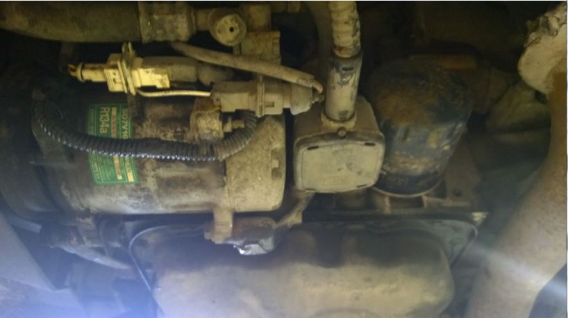

The project continues. Air Conditioning works now (filled), but it may be temporary. Pump is quite noisy:
activa_aircon.JPG [ 47.7 KiB | Katsottu 38783 kertaa ]
Also note the block heater wiring between pump and oil filter. Not the most elegant solution.

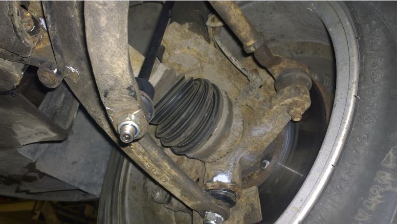

New lower balljoints and bushes, and sway bar link:
activa_bushes.jpg [ 67.67 KiB | Katsottu 38783 kertaa ]

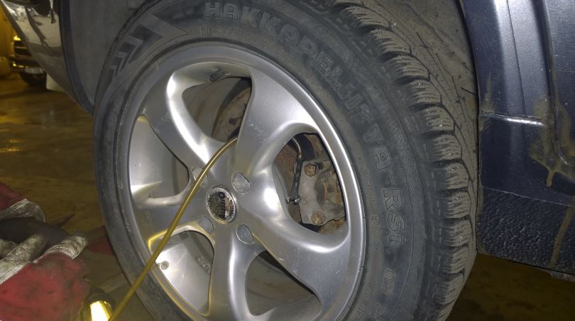

And finally, bleeding the brakes after correcting the position of brake pad on front brake. Xantias have certain notch in brake pad that must match brake piston, in this case one pad was incorrectly place. Now it is corrected.
Bleeding in progress (Suspension -> high, procedure LF RF LR RR, while all the time keeping at least 10kg pressure on brake pedal, engine running. If back end does not bleed correctly, apply more pressure to brake pedal with pumping motion, never releasing the pedal):
activa_brakebleed.jpg [ 61.3 KiB | Katsottu 38783 kertaa ]
