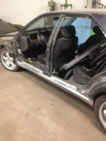

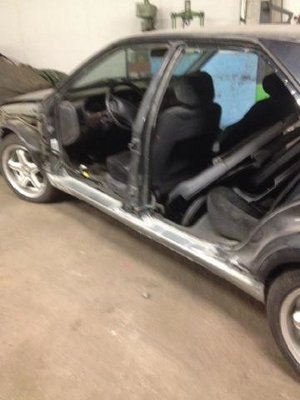

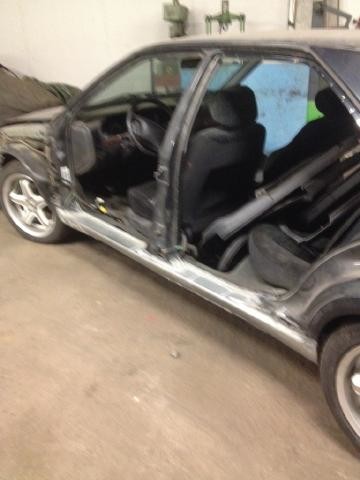

Small update: Xactiva is finally in welding process, both sills are being restaured to perfection with known Estonian maestro. Pics to be posted soon...

... would be easier to build a new car... Current status:

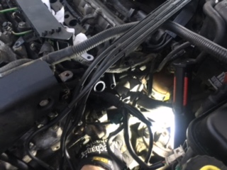

Misbehaving speed sensor in differential casing freaks out the whole car. Engine and activa-system too. Surprisingly speed info provided from ABS is not used in this car for speed sensing - separate sensor is in "nice" place.
Removal, part one:
https://youtu.be/n0CPe7C9pUE" onclick="window.open(this.href);return false;

ds-jekkeri kirjoitti:Surprisingly speed info provided from ABS is not used in this car for speed sensing - separate sensor is in "nice" place.
From underside it is very easy to reach...
ds-jekkeri
Liittynyt: 11.08.2010 12:26
Re: Xantia Activa V6 restoration
Interesting, are we speaking about the same car? Sensor under intake manifold and connector between intake manifold and gearbox, in 5 cm high "cave"?
My hand in the picture reaching for sensor.
Jasu is most likely correct! The sensor I removed with huge work is RPM sensor that reads the teeth in flywheel - I removed the wrong sensor. Nicely done...
