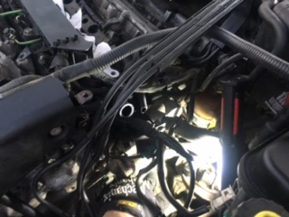

Misbehaving speed sensor in differential casing freaks out the whole car. Engine and activa-system too. Surprisingly speed info provided from ABS is not used in this car for speed sensing - separate sensor is in "nice" place.

Kirjoittaja jasu
ds-jekkeri kirjoitti:Surprisingly speed info provided from ABS is not used in this car for speed sensing - separate sensor is in "nice" place.
From underside it is very easy to reach...

Kirjoittaja ds-jekkeri
Interesting, are we speaking about the same car? Sensor under intake manifold and connector between intake manifold and gearbox, in 5 cm high "cave"?
My hand in the picture reaching for sensor.

Jasu is most likely correct! The sensor I removed with huge work is RPM sensor that reads the teeth in flywheel - I removed the wrong sensor. Nicely done...
