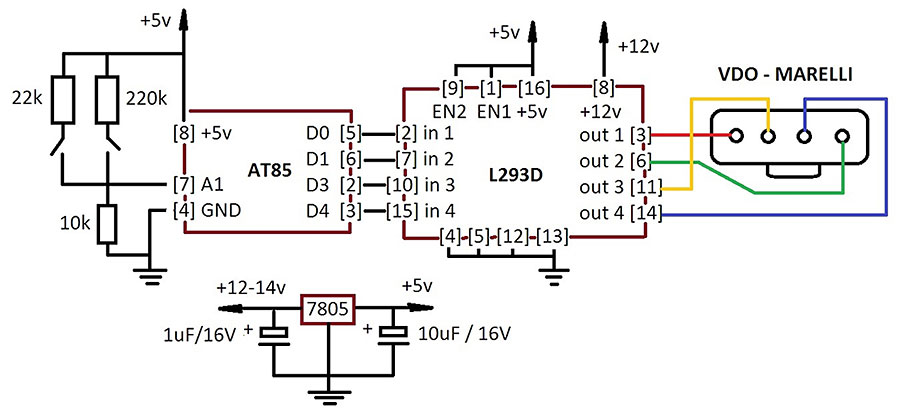

And to shrink little more the project:
- Atmel tiny 85 (@ 16Mghz / 4.8V - PLL)
- L293D
- 10k , 22k, 220k
- 2x push buttons
- 7805 , 1uF , 10F caps

Let the LHM be with you...
